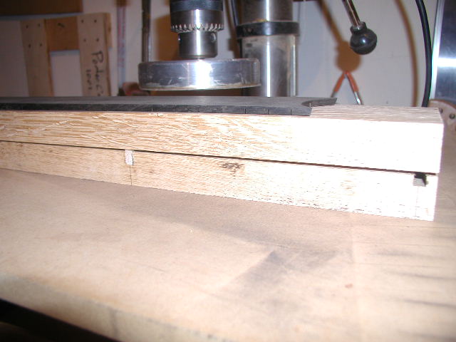

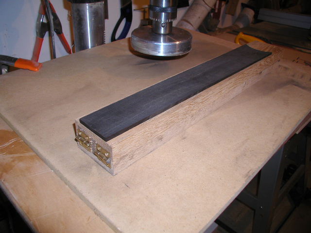

Claire - I second everything Udi said. I also plane a little extra from the 12th fret to the soundhole on the underside, since the plane of the neck surface is at an angle to the plane of the top in the upper bout region.
I don't like planing the top of the fretboard very much, and instead have built a sanding jig with a replaceable shim that I tape the fretboard too and then pass under a sanding disk. I'm close to getting the geometry written up so that I can sand the long taper into the board before sanding the extra bit above the 12th fret, based on measurements off the guitar. I'll make that available when I get out from under the billion other writing tasks I seem to have right now. Here's the jig.
Jim Kirby
